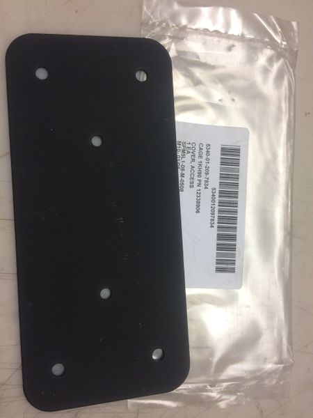

The panel is behind the lights
That cover as rusted as it is surely has let water in the wiring. Obviously you should replace the cover and probably the one on the other side as well. They cost about $20 each.
Can you recommend where to source the access panel? Indeed , the other panel is also rusted badly. I’m doing a search and using words, “M998 front light access panel” and not coming up with anything on google or eBay. Thx for ur help.

If those covers could talk (LOL) they would have a heck of a story. Poking around and getting different problems... IS a problem.
These are all good question...and difficult to respond to. My best advice is to study the wiring diagram above. It is the "map" to this fix this problem. Wire tags are like highway numbers... so one shouldn't get toooo lost. Match the parts wires to the ....MAP, paying close attention to everything and clean , inspect all connections. reassemble with a little dielectric grease.
Having a short circuit could ?? have toasted the flasher unit. Don't forget to check out the hood to body connector. Could be a problem there with the clue of rusty covers.
Covers, one could make ? likely cheap from suppliers. Google search.
