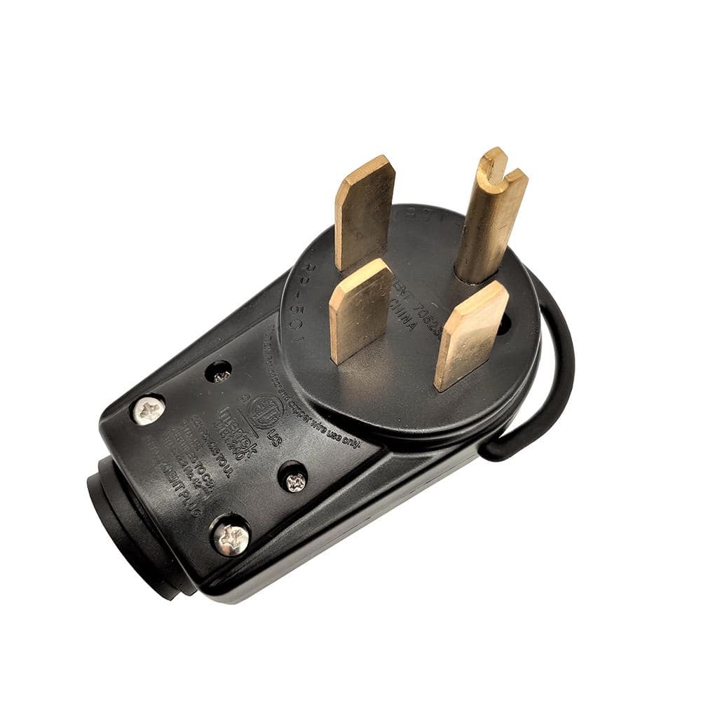

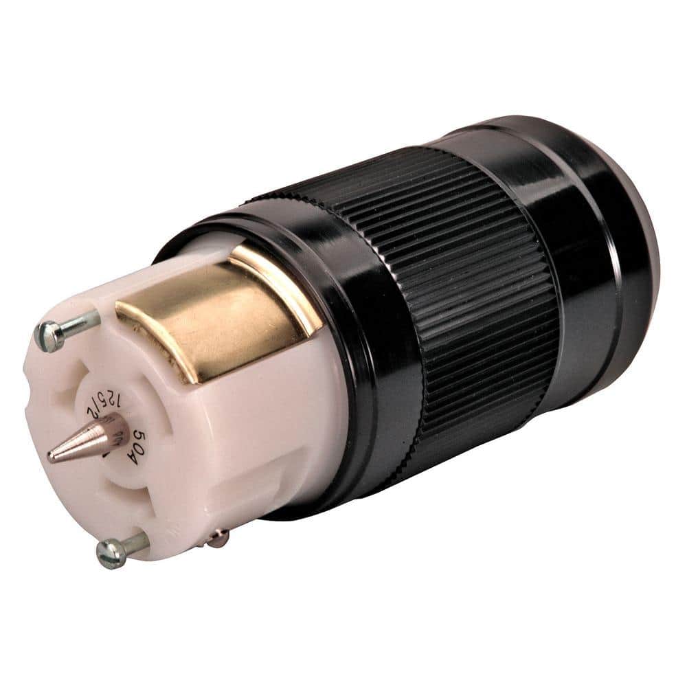

All hookups will be different but I just used a 50 amp RV box on my generator. Make sure if you connect to a main fuse panel that has the neutral and ground bonded that you remove the bonding strap in the generator.
If you have spaces available in your main that align or can be rearranged to use a interlock That is the easiest way in my opinion.
I would mount a 50 amp RV outlet on the generator.
Put a 50 amp generator inlet box on the house.
Wire the inlet box to the main fuse panel with an interlock preventing any backfeed. These will be panel specific so you will have to find the one made for your panel.
Connect the generator to the inlet box with the appropriate connectors.
