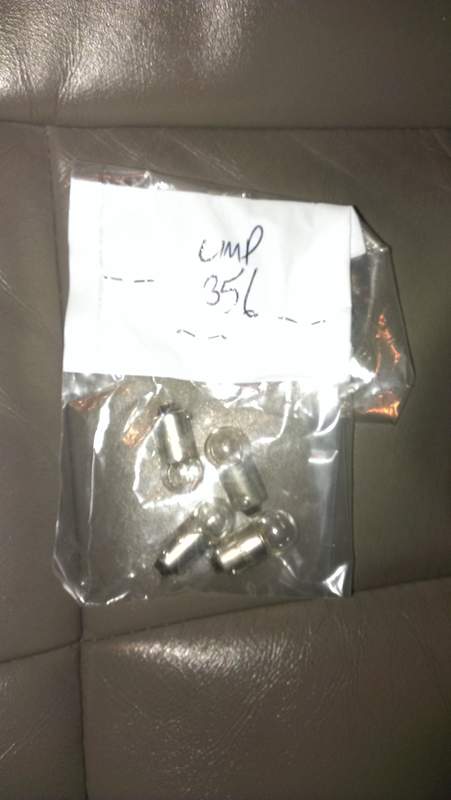

On a trip to NAPA today, I picked up some new instrument panel light bulb (upgraded to brighter # 356). I plant to install another red gauge light in the middle of the panel.

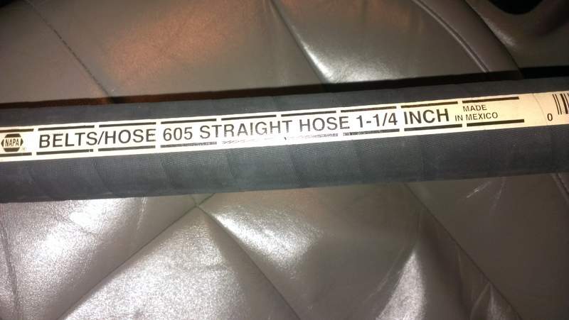

A slobber/road draft tube. (1-1/4" ID x 3')

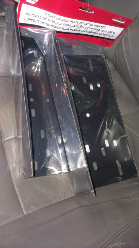

Some license plate brackets for front and rear.

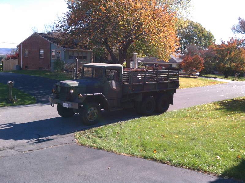

Update: Drove 60 miles with 2 cord of firewood though a couple passes in Appalachia without issue. A little low on power with the load, plus the brakes required a bit more force to stop. Also my turn signals stopped working. I checked and cleaned the flasher relay ground , but no change. Next up is a flasher box replacement.

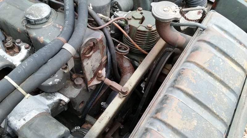

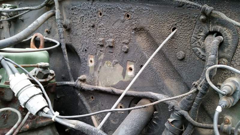

Can anyone tell me what would have been mounted on the firewall that is no longer there (shown in picture)?
localmusicfan
az
Isn't that where the quick starting fluid canister normally mounts? Check out episode 8 on the series "so you want to own a deuce and a half" on youtube.
