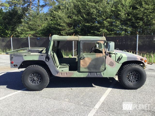

That being said I "won" the first thing in my life, lol, a 1990 M998 4 door truck body. She needs some serious love but I have my plans. My wife on the other hand is pissed at me and doesn't seem to understand a man needs his toys.
Since I just won today I finished everything required. Hold Harmless is complete, EUC is completed (and the wait begins), and the payment has been wired. All is left is to figure out who is going to ship the beast from Maryland to Georgia (suggestions please). Here is a pic I am sure some of you have seen on the auction block today. Of course this is one of their photos but when I can I will be sure to show photos as my machine arrives home as well as before and after shots as she proceeds through its restoration.

Most definitely. I have been doing a lot of research using the wealth of knowledge here. I already know it needs some minor parts just from govplanets inspection.
Driver side mirror assembly
Driver seat back cushion
X doors (paint doesn't matter as long as they are not delaminating)
Batteries (have no idea what the battery setup even looks like on a 1990)
I want to go ahead and get some problem areas taken care of once I receive it for reliability people have mentioned if it needs it.
A walboro lift pump
Pcm relocation kit
Glow plug control box update
We all know the maintenance needs to be addressed immediately and at the suggestion of many on this forum I decided to stick to conventional oils until I can replace gaskets and such. I decided to just buy a bunch in bulk so I can flush the system real well before hand then change the fluids again after the first 50 miles to be sure I got anything out of the system that may have broken free from the fresh oils. Definitely changing out the rubber hoses and replacing the belts as well as greasing all the suspension components and running some fuel system cleaner. Not to mention replacing the oil, fuel, and transmission filter and draining the water seperator.
I do want to completely pull the coolant system, blow out all the fins to remove any debree as well as wash out any old fluids and straighten bent cooling fins. Sounds like a good time right.
The EUC started processing on the 27th of June so I don't expect to be seeing it till late August to early September best case scenario.
Anyone care to help me decide on a color? I am leaning towards gloss black but I think a Matt black finish would be cool too. My brother in law is an exceptional auto painter and has everything to perform a pro paint job. He's even won first place at some pretty big car events with his work, so I'll leave that to him.
Any advice is greatly appreciated. I have built several cars in the past but this one so far is my favorite and I haven't even seen it in person yet.
I'd like to have most of this stuff together when it gets here so any help would be awesome. Thanks.
