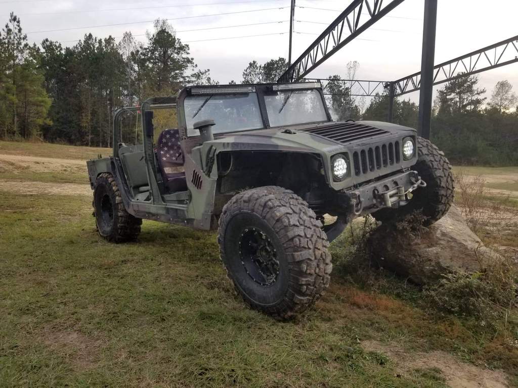

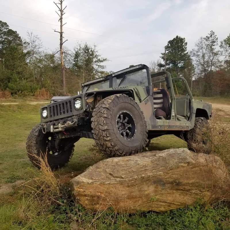

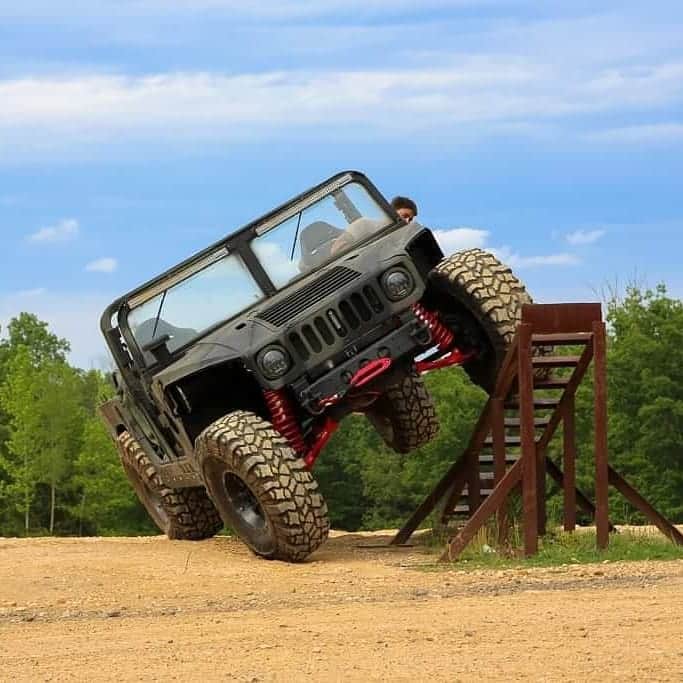

Since my last post, I have changed career paths as well as went completely insane with my build. The trucks drivetrain, to begin with, has been completely upgraded to a 10k drivetrain. Both differentials are now AuburnGear Ected Electronic lockers and have been rebuilt. She now rides on 41.5 x 13.50 R 17 Pitbull Rockers and a set of 17" Raceline Assault wheels +20mm.

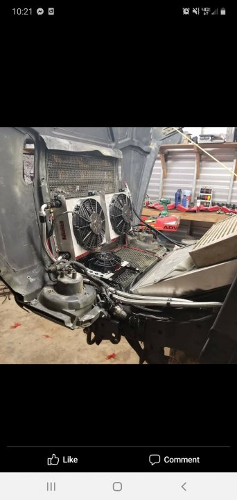

The cooling system has been upgraded to a Predator Motorsports aluminum racing radiator fabbed by Rod. The tri cooler has been deleted and replaced with two 14" oil coolers and one 12" oil cooler. 14" engine oil, 14" transmission, and 12" power steering each with there own electric fan mounted on the back of the hood vents. I did this to create space between the different cooling systems and reduce heat soak and increase air velocity by having less surface area to pull air through per fan. This allows the engines fan to pull air exclusively through the radiator and not fight to pull air through the tri cooler as well as the radiator.

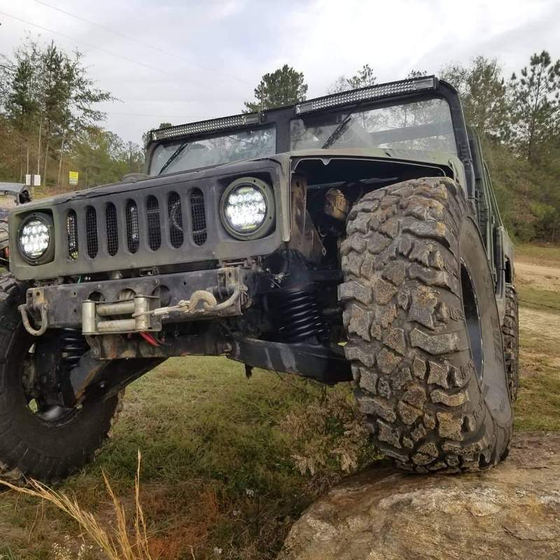

In addition, I have been working with Michael E Hoffman with American Humvee to test a larger spring lift. With a set of his front springs and a 2" lift spacer in the front and a set of front springs in the rear, I realized 4" of lift on my lightweight m998. I also realized a huge ride difference and spring flex which you could see for yourself if I could get these **** photos to load.

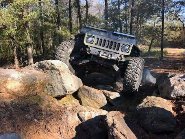

Yes, a lot of you will hate (but I really don't care BTW) but I chopped the hood to allow for better spring travel and trail clearance. I use the truck primarily for offroad use and have scaled some vicious rock trails with my setup.

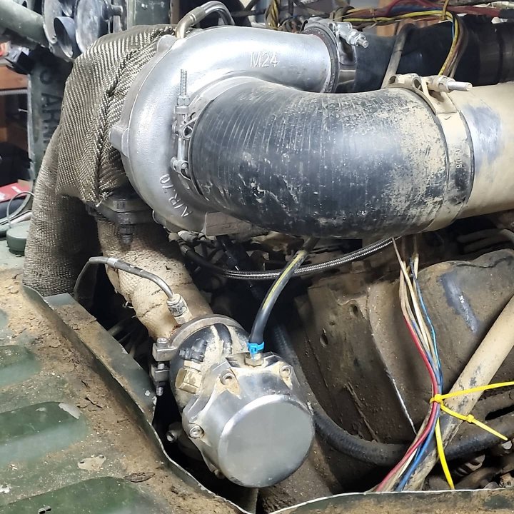

My turbo design is now in its 3rd generation. I began trying the side mount design because I believed it had the room. It does have the room but it is a bad design when we have the ability to access the back of the engine as Humvees does. Side mounts also block the entire side of the engine and make it very difficult if not impossible to access the injectors or glow plugs or anything along that side. All that being said I took the route of using newer model turbo diesel center mount turbo manifolds and fabbed a y pipe to connect the two to a t3/t4 turbo flange. Instead of using the HX35 turbo I opted for a G35 Ball Bearing turbo that is water and oil cooled. I used braided steel lines with AN fitting for all connections and sourced my oil feed from my oil pressure sensor. The water supply was easy as I just plumbed the radiator return line through the turbo and into the reservoir. The reservoir is custom fabbed by a friend and is all aluminum. I used 2.25" tubing to match the outlet of the turbo with silicone couplers and T clamps to connect the aluminum tubing. The Front mount intercooler 3" thick 23" wide and 11" tall with 2.50" inlet and outlet. I opted to keep the mil-spec intake manifold for hood clearance and had quad star tuning to fab an intake cap with a 3" mandrel bent steel pipe and a 3" to 2.5" silicone coupler with t clamps to connect it to the rest of the intake system. The small size piping is maintained in order to speed up the air volumization (is that a word) process to build boost. The PCV port on the intake manifold was blocked and used as a boost source for one of 9 street glow gauges (inexpensive and very attractive not to mention accurate gauges). The PCV dump tube is re-routed to the silicone coupler connecting the stock intake box to 4"aluminum elbow. As stated 4" aluminum pipe and silicone couplers were used as intake piping from the stock intake box and run to the 4" intake side of the gt35 turbo mounted to the custom fabbed turbo Y pipe. This setup is leaps and bounds more efficient to the original setup and much easier to work with. The Turbo door used for turbo model Humvees is a must if you don't fab your own to clear the turbo. I also took the extra time to titanium heat rap the manifolds and Y-pipe as well as added a titanium turbo blanket to keep temps inside the engine bay to a minimum.

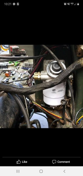

Fuel delivery has become an adventure. I discovered my truck was reset in Maine in 2016 and was fortunate enough to get a new model DB2 injection pump. I advanced the timing +2 degrees from center and turned up the injection pump. Using all AN fittings and braided steel lines I deleted the factory fuel tank. Using a 20-gallon fuel cell in the bed and deleting the factory mechanical fuel pump I reworked the fuel lines to run a Holley mighty mite electric fuel pump and AN fittings and lines from tank to a custom fitted spin on Wix fuel filter with primer. From there I ran AN fittings to the injection pump and a custom made feed the beast setup to better fuel the pump. The injectors also got treatment and were rebuilt using Marine style fuel injector nozzles.

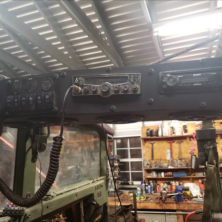

INTERIOR MODS: Phoenix Hummer Repair is in the process of fabbing me a center console to rival all offroad center consoles. STAND BY TO BE AMAZED lol. It should be my new location for my stereo system, two 6 1/2 speakers, my CB radio, a place for a 9" screen, and 12 toggle switches for accessories that seem to grow like crazy.

I have almost completed my turbo setup. Still working on the turbo i want to use and in the market for an investor to put the first prototype on there truck.

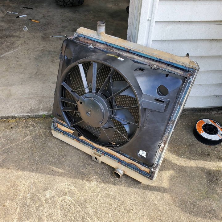

Also, i have completely reworked the cooling system on the truck. The cooling fan is now a 100% functional electric fan converted hmmwv. The cooling stack has been dissected and now has the cooling duties split between 3 seperate oil coolers each with their own 180 degree thermostat and electric fan. The radiator is a Griffen all alluminum radiator with a custom steel tube shroud and a two stage 99 crown victoria electric fan modified to fit the larger hmmev radiator. It has two seperate switches to activate the low speed at 185 degrees and the high speed at 200 degrees. It has been torture tested and exceeds my expectations especially after hearing all the it wont work negativity.
Earlier i mentioned a long travel setup. The original setup was a huge bust as the investor decided to stop investing. There are various reasons but no one has asked my side of the story so ill just leave it at that in hopes the other party has had enough integrity not to sling shade without giving me the opportunity to defend myself. It was a cool but very faulty design that had a lot of promise with the right investment.

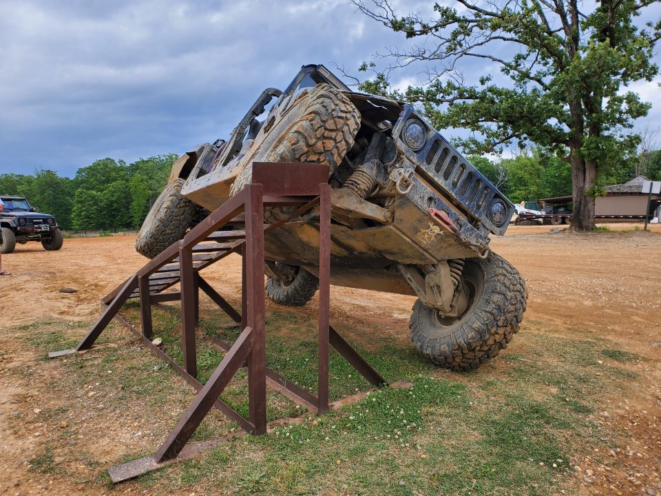

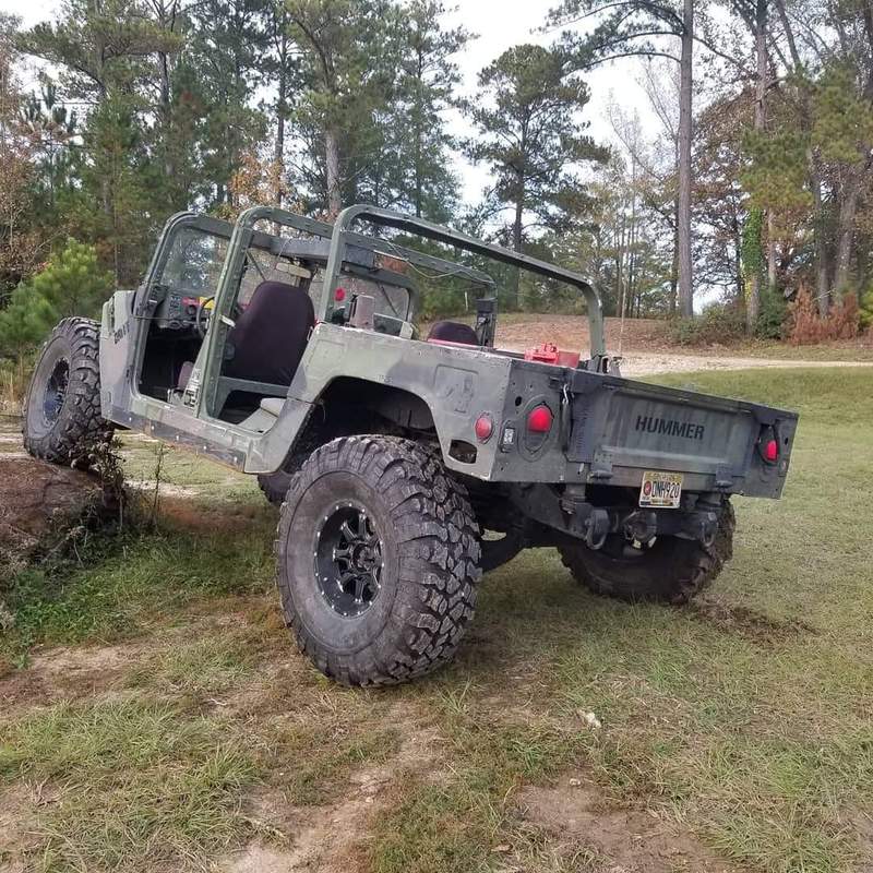

I removed all of that setup and went back with the softer springs i originally had been helping Mike Hoffman sell for a time. I have completely incased the underbody of the truck in 3/16 steel with the help of some used skids off of Mark @ Mod Mafias humvett, rubber duck 4x4 under skids and Jeremy Johnsons awesome full rock slider skids. All the added low weight greatly improved the trucks stability. It is ridiculously stable with my new weak link being the bead of the tire on the rim. Yes it is all the way to the top and could go much farther if it had the length.

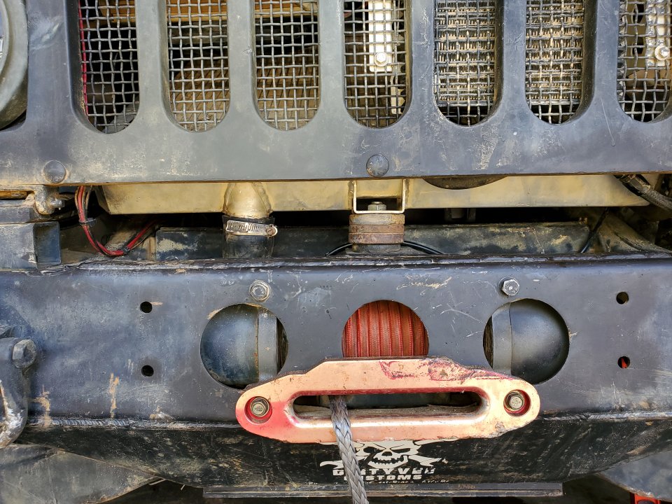

I have also deleted the fuel tank and replaced it with a 15 gallon fuel cell in the center of the bed. I also am still using a 12k 12v badland winch on a 24v system that i custom fit behind the factory m998 bumper i reinforced. Yes, i was the first one to do it, at least that posted it.
I have also done some interior work. I have a lot of small 12v components running off a cheap 100 amp 24v to 12v converter. I custom built an overhead console to hold all of the components as well as double as a speaker inclosure. It was built out of 16 gauge steel .5" square tube and 16 gauge steel plate. Its overhead location is not only convenient for controls to the driver but protects it from deep water.
I have also converted my fuel lines entirely to braided nylon lines and incorporated an electronic lift pump. I even converted the fuel filter to a modern primeable spin on fuel filter with a 5 micron filter, much better filter compared to the i think 20 or 15 micron military filter that is hard to source. I can pick up my filter at any auto parts store, no longer need to source a cadillac valve or switch or worry about any if the failure points, my power steering and brakes are noticeably better, as well as improved engine noise and throttle response.
My steering system is significantly beefed up, using the Alpha drag link and idler arm, a hybrid pitman arm made of .25" wall DOM tube and a worn out early style pitman arm modified with a 7/8" heim with the taper drilled out of the drag link to accept the larger bolt. I also fabbed both tie rods with the same DOM tube and heims drilling out the taper in the portals and drag link connections respectively.
