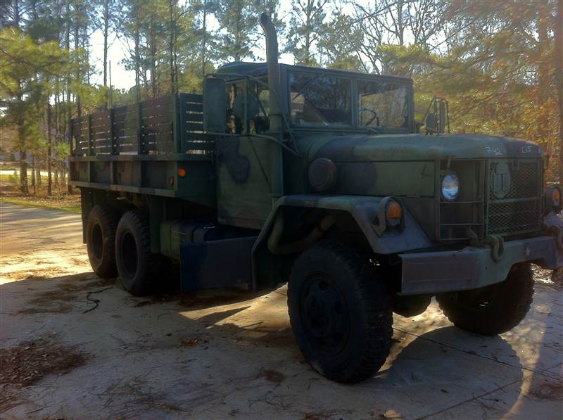

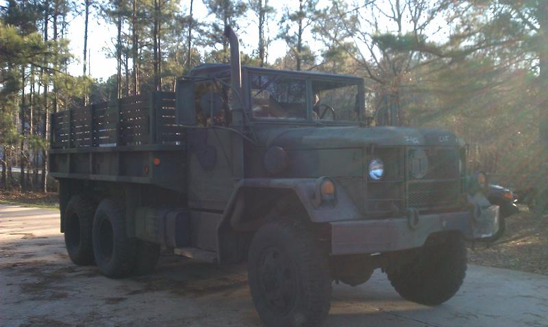

I drove my "new" M35A2 home on Saturday, 12/31/2011. She did great on the 80 miles home. That gave us a chance to get to know each other better. We had been "dating" for about 3 months while she was living at Clinto's house so we weren't strangers, but this drive was the first "quality" time that we had spent together.
She is a 1970 Kaiser Jeep M35A2 WO/W, D-model engine and turbo. She's clean, mostly straight and rust free and in good running condition. The engine makes good power, starts easy and so far, she hasn't soiled the driveway! She drives good and makes 55 MPH on level ground, but I tend to drive her 45-50.
I've got big plans for Betty so I thought I would start a thread to document our progress.

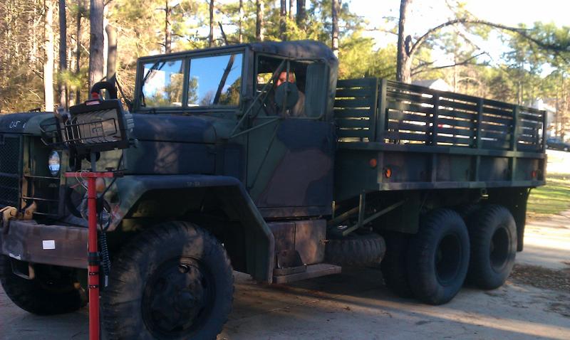

I've posted these photos elsewhere, but here's a couple just to start this thread.

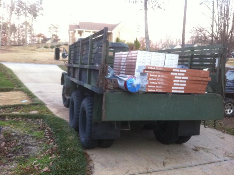

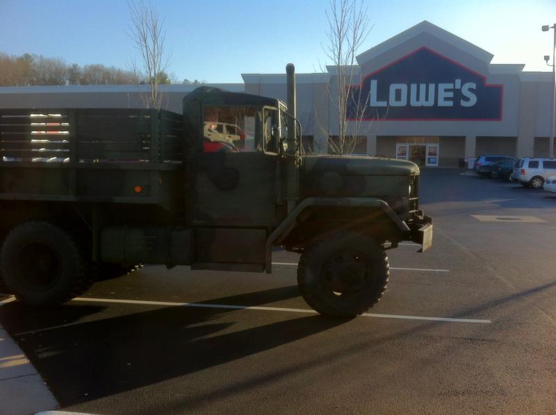

We took Betty to Lowe's to pick up the new flooring materials for the house and ran a few other errands around town before heading home to unload. She did just fine other than belching out a pint or so of coolant at AutoZone. She wasn't hot at all but she was just burping out liquid coolant for 2-3 minutes. She hasn't done it again and she isn't running hot at all.

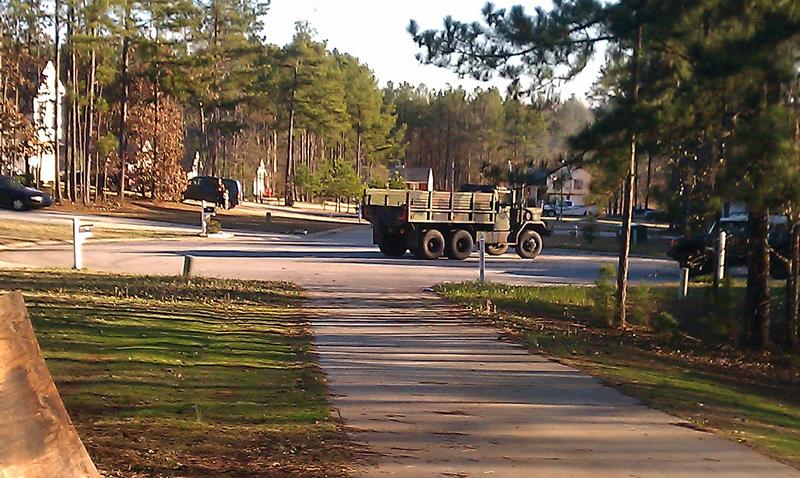

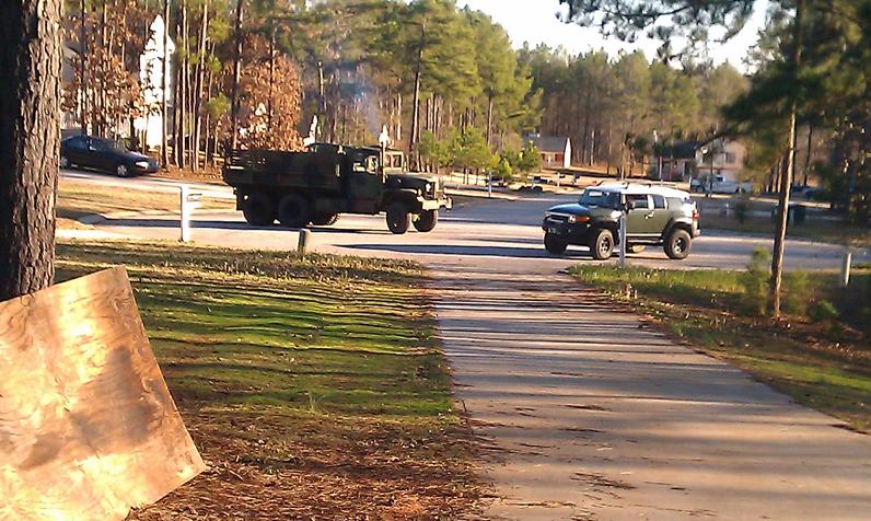

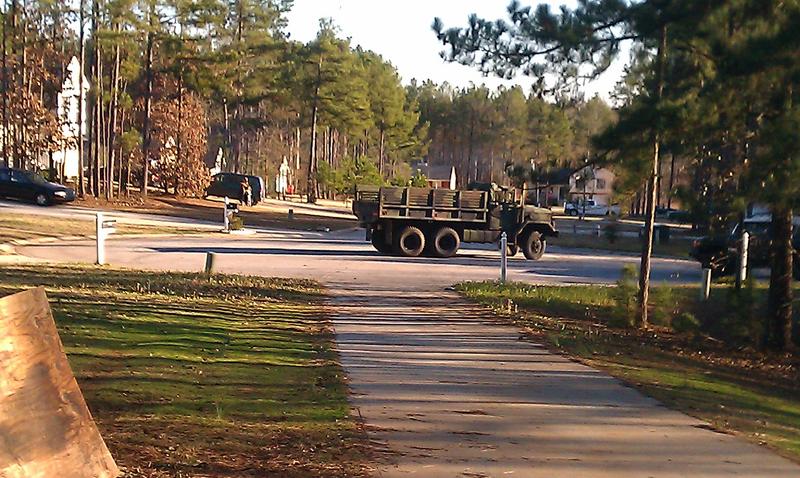

Took a drive over to my Father-in-Laws house to show off. He has a grading and hauling business and they do most all of their own truck and equipment maintenance. He volunteered to help me with that right front king pin problem and I'll take him up on that for sure. He also wants to check the flow on the IP but I want to get the fuel lines replaced before doing any adjustments.
12,596
1,129
Thanks for all the kind comments. We appreciate it.
We're glad you like Betty, there was a lot more to do than we ever anticipated! But it cleaned up really well.
I shot some pics as you were leaving Saturday. Enjoy.
You guys are more than welcome to visit anytime.
