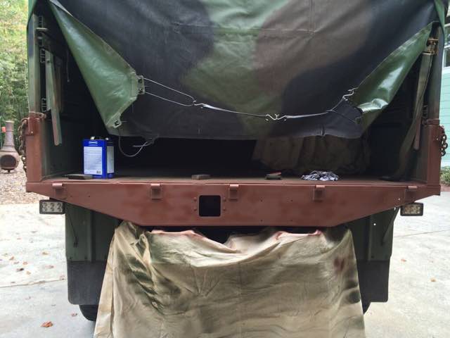

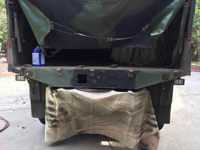

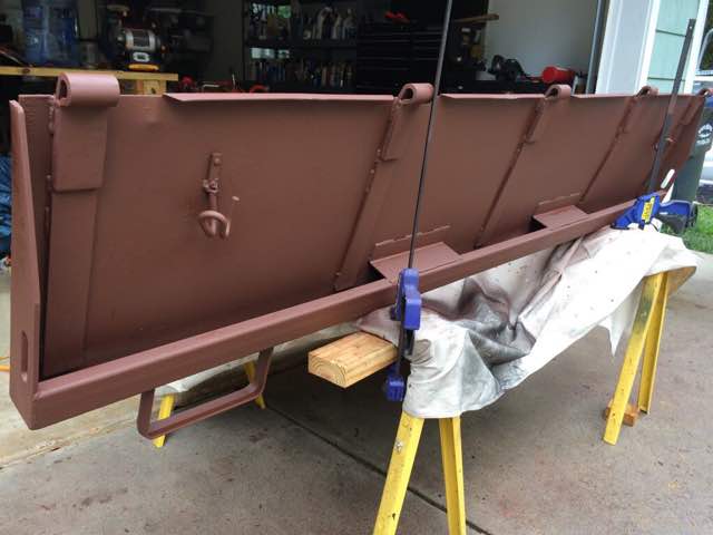

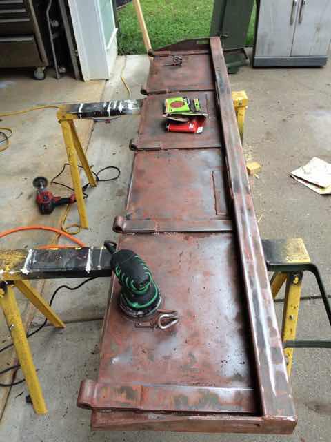

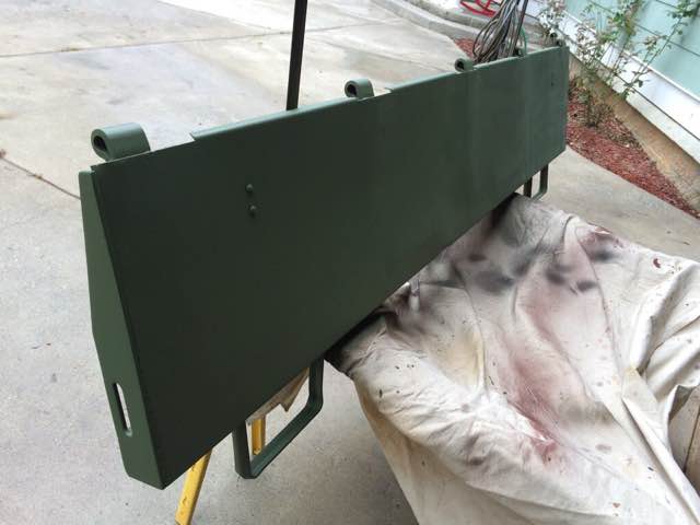

Got the tailgate primed and base coat of 383 Green done. The hardware is soaking in a bucket of phosphoric acid. Maybe get it finished up later this week.

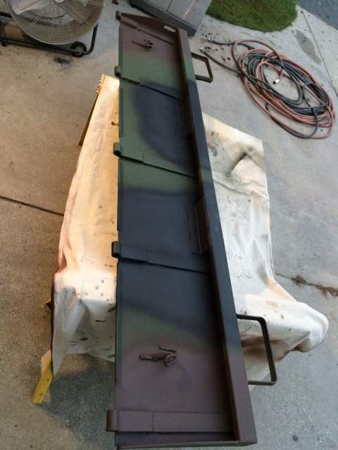

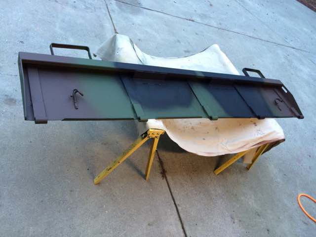

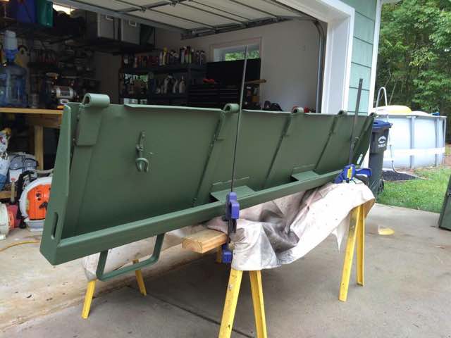

The days and days of rainy wet weather really slowed down the paint work. It's clear and dry again, so we're making a bit of progress now.
I may be committing some kind of sin, but I'm not painting the "proper" 3-color camo pattern. Instead, I'm matching up the patten to the cargo cover. If I like it, I'll keep it that way. If not, it's just sand paper and paint.

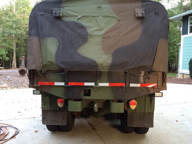

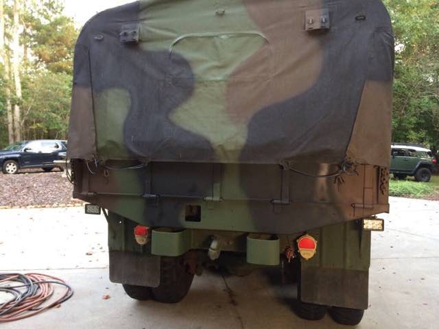

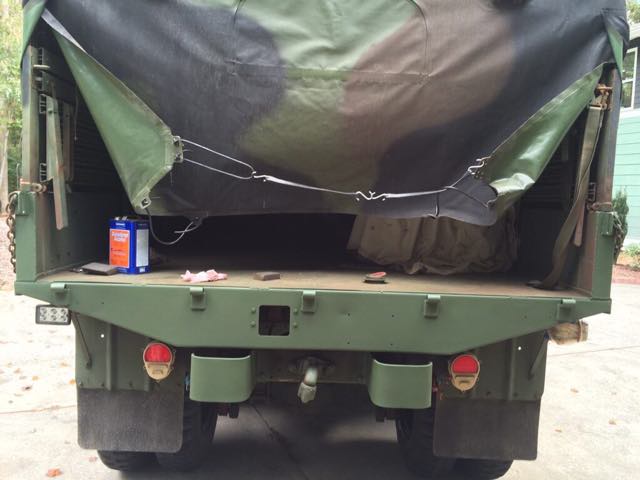

Well, we put the tailgate back on and finished tweaking the camo pattern. I ordered all new DOT reflectors that should be here in a day or two. The reflective tape is just mocked up for now, but I think I'm going to put it on after the paint cures for a couple of days.
I like it.

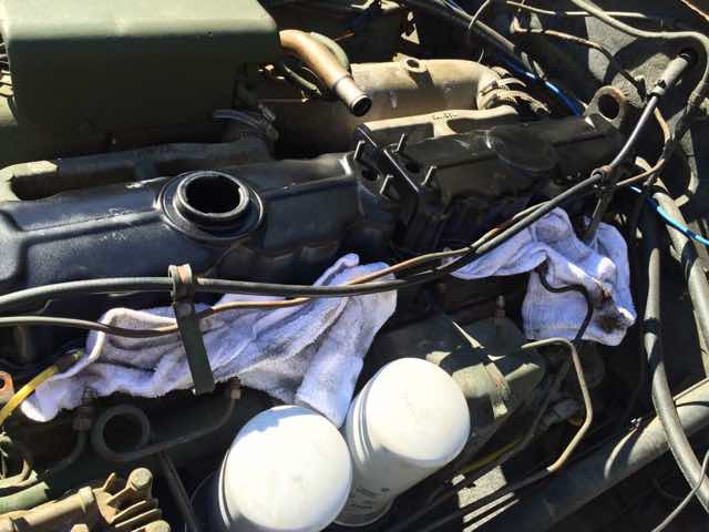

The next morning, my son and I pulled the valve covers and set the clearance on all valves. None were terribly off, but I found a couple a bit too loose and a couple of them were too tight. We also pulled all of the injectors and they're getting cleaned and pop tested. None of them looked bad but I'm interested in finding out what pressure they popped at before he changes them. $19 each is a pretty good price. I just hope he does a good job.

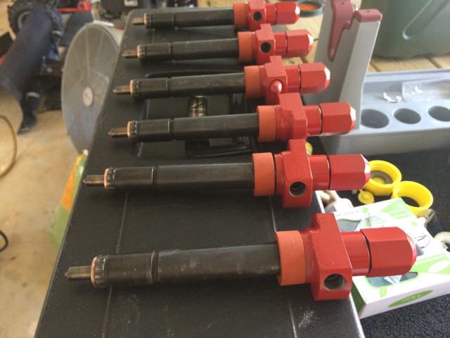

Getting the fuel injectors tested and set is proving to be more difficult than expected. But, that's being covered in a different post.
I did make progress on cleaning, painting, and other chores related to putting it back together.

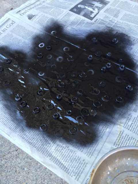

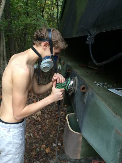

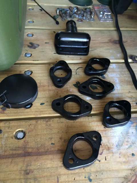

I media blasted and acid washed the hardware and valve covers. I very carefully cleaned and prepped the exterior of the injectors being very careful to not damage the nozzles and I kept the threaded ports sealed with foam plugs.
Since I couldn't find engine paint in 383 green, I decided to get fancy and go with black with red injectors. The return lines are yellow. You can't see it until you open the hood and it satisfies my "custom hot rod" needs. If I don't like it, I can always shoot it green again.

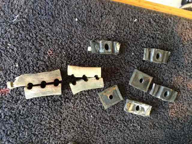

I have to make replacement injector line holders, as both the wooden and the rubber blocks were pretty well shot. I figure I can make new wooden blocks pretty easily. I've got a lot of hardwood scrap and the tools.
I might just put the injectors back in "as is" for now. I can always pull them back out when I come up with a good pop testing solution.
I'm debating whether to pull the remaining injector lines to clean them up and paint as well. I have to have it back together and road ready for Zout's April event. Decisions, decisions.....

You can get replacement parts kits that gave all the pieces to hold your injector lines from Tnj murray. I bought a set at the Gilbert show this past september, think it was about 40.00 but it has all the brackets, bolts, isolation blocks.
Also, S.S. member Ford Mechanic has a thread about callubrating and resetting injectors. May be worth looking at.
