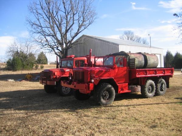

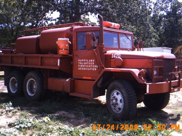

I am also a volunteer firefighter. Our department had an M35A2 with two 600 gallon tanks. When full of water and with the weight of the pump, hoses, and tools it was obviously over loaded. It did handle fairly well if taken slow (with 1200 gallons of water, slow was the only speed she would do). It is a blast running code 3 at 30 mph. :mrgreen: There were only a few of us on the department that would drive this truck. I live farther from the station than most of the guys so by the time I get to the station this is often the last truck there. I'm fine with that since I obviously liked the deuce so much that I had to have my own. :D
We are now in the process of replacing the A2 with an M35A3. I made the case that we should only put one 600 gallon tank on the A3 but others decided to go ahead and put two 600 gallon tanks on it. The new tanks are baffled (the tanks on the A2 were not). I guess we will see how it handles but we will have the option of only filling one of the tanks (which I will push for). I have heard that keeping the tires at max pressure helps the stability with a heavy load on the A3.

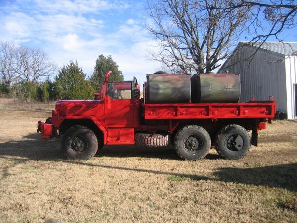

Here are pictures of our old A2 and the A3 which is still being setup.

we already drove it around loaded. as a matter of fact... the day we got it... 3 hours after we loaded the hoses and various wildland tools we usually keep on that truck, we had a reported structure fire. it was the last truck there, and i drove it.
1100 gallons of water. yes, it accelerates slow. yes, it will do 50 indicated (verified as 47 by GPS) on the open road with that payload. it isnt right though. that tank is centered over the two rear axles. it should be farther forward anyway. we're looking for a different tank.
honestly.
i like the A3. i'll be trying to keep it in service, but the tank that the state installed just wont work on that truck. good luck on getting a new one. i honestly hope it works out for your agency.
