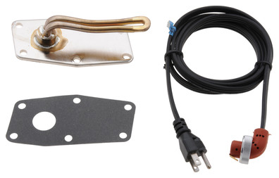

I installed the same heater and mine only gets warm and not hot, seems like it now leaks a bit from thermostat housing. Could it be touching the block maybe?

I had the same problem. Tighten the nut on the receptacle and it should stop the leak (I believe there is a gasket on the backside that won't seal unless that nut is tight).
You are correct...the next one I install I will be sure to tighten the element BEFORE I install the plate.

I just picked mine up today at carquest but doesn't come with bolts/screws what size do they take or does it use the old ones?
You reuse the bolts from the inspection plate. If you want new bolts, they are standard 1/4" coarse thread bolts.
