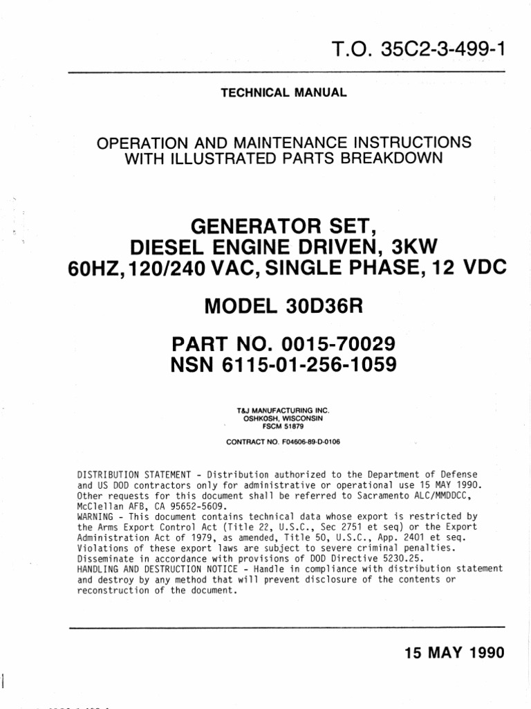

Pow'R Gard 30D36R 3kW Diesel Generator
CallMeColt
1,017
1,468
Wilson County, Texas
Old thread I know.
Picked up a Pow'r Gard 30D36R on auction with 50hrs on it. Started right up!
Need replacement key/switch. It’s broken off in the run position.
Need a replacement battery but have not found a model #/spec to cross reference.
Need a wheel kit. Baldor serms to have discontinued the part.
Tank has some algae, any suggestions for interior cleaning procedure after draining?
Odd question I know, but how do you know the hours on it? Mine doesn't have an hour meter.
rcamacho
768
838
Bainbridge Island Wa
rumplecat
2,037
221
North West Arkansas
One more question, where are you getting your air filters, mine came without one and the DG3E has a different filter housing and filter!
