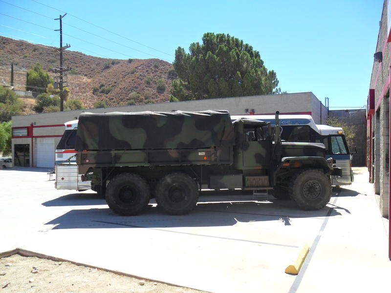

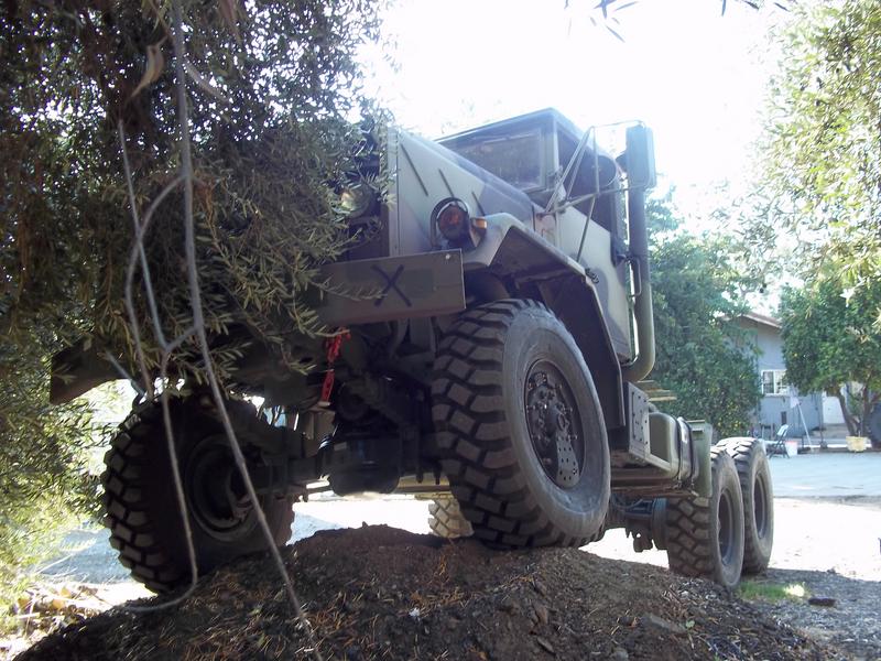

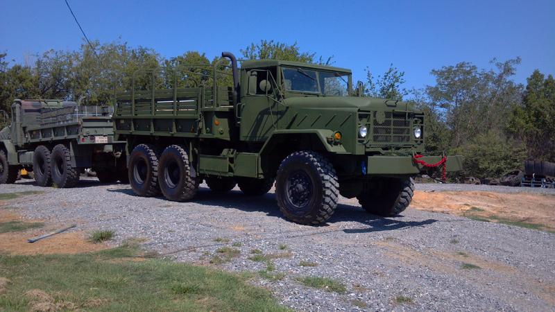

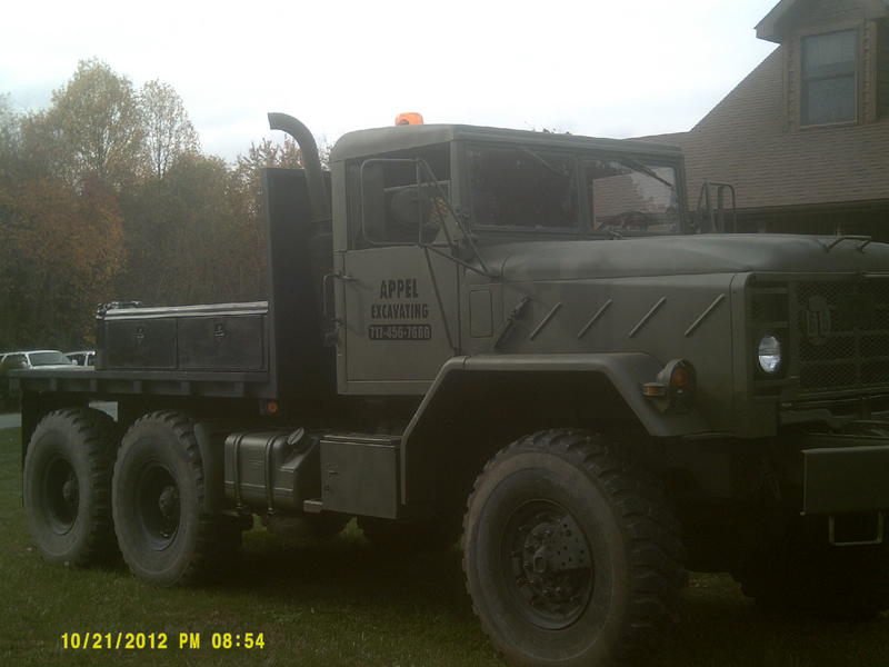

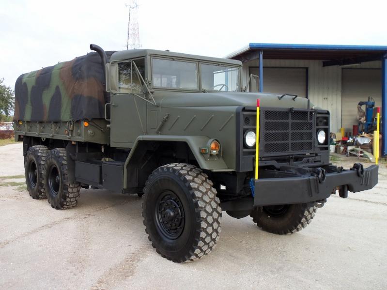

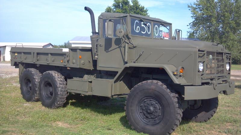

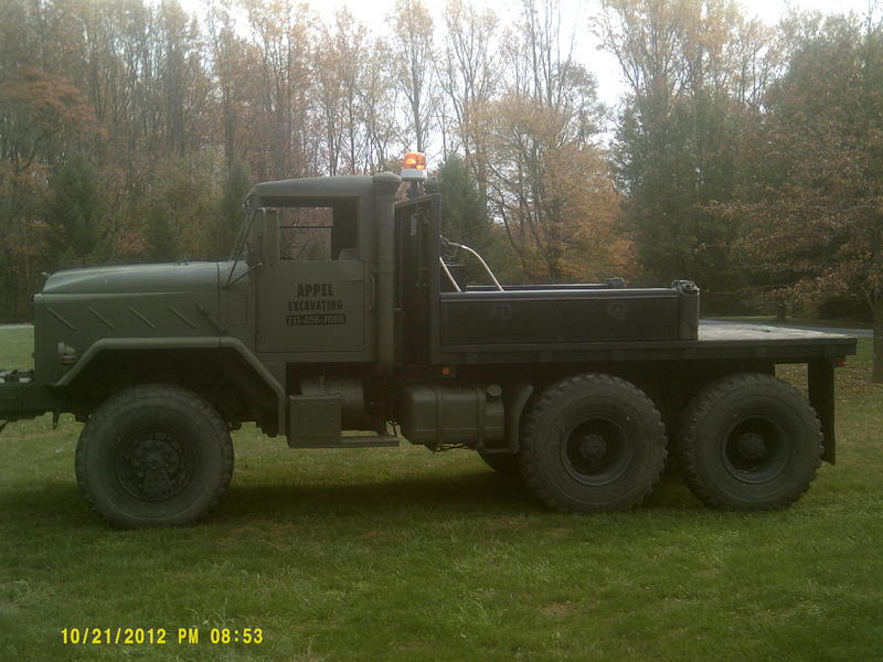

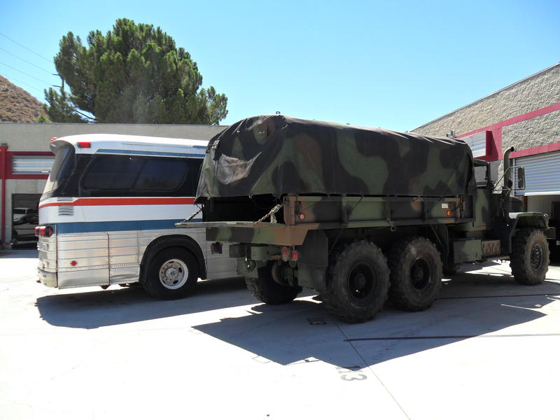

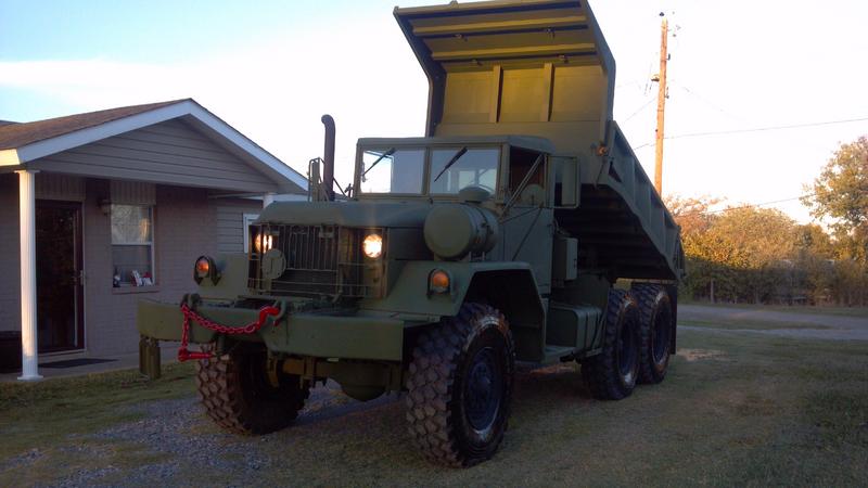

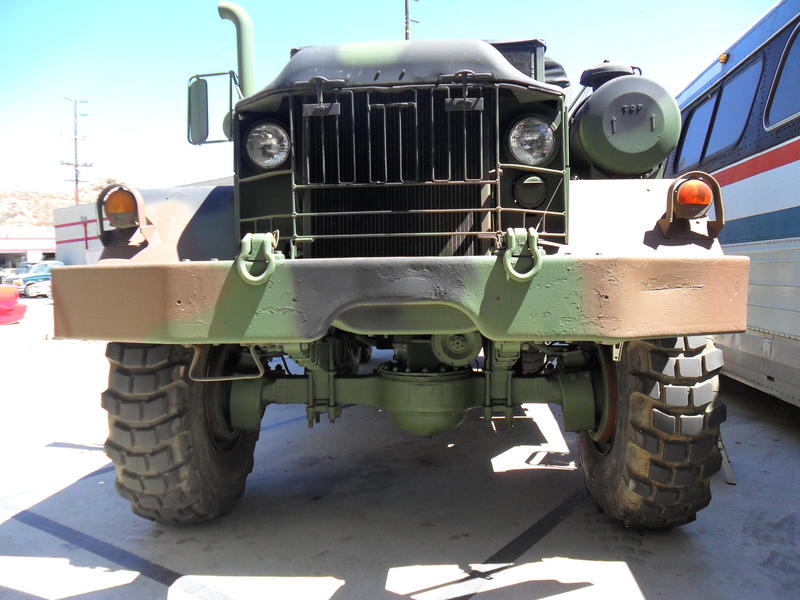

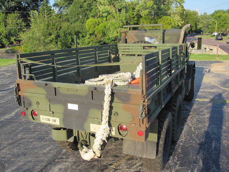

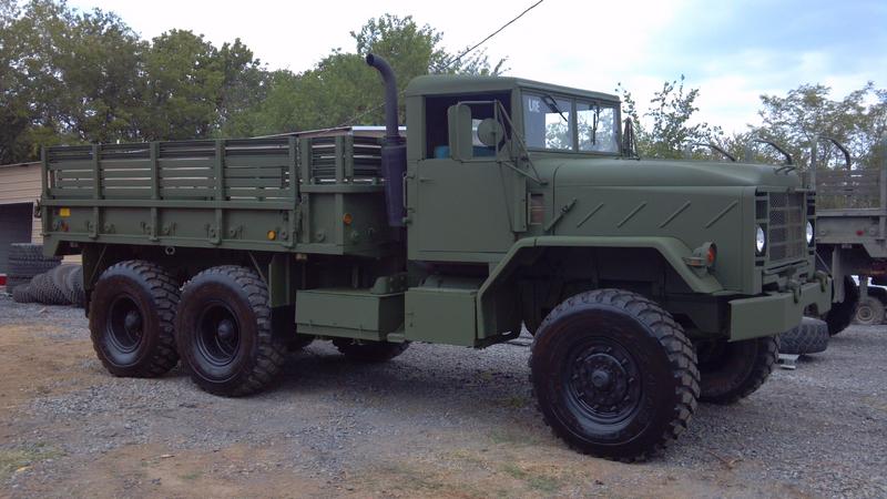

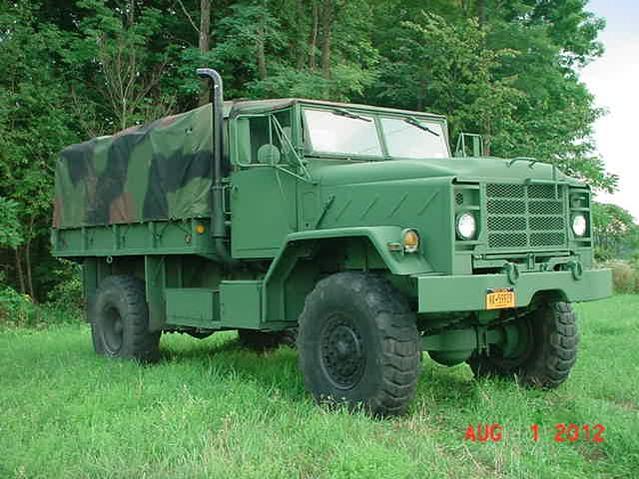

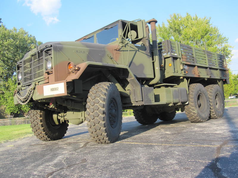

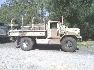

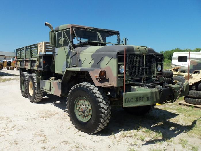

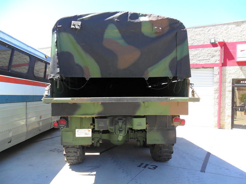

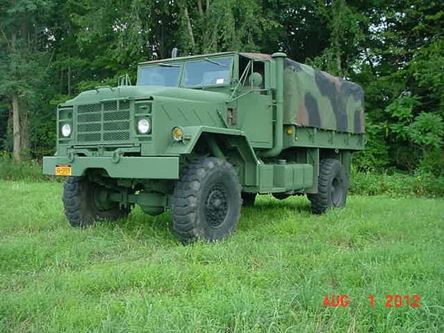

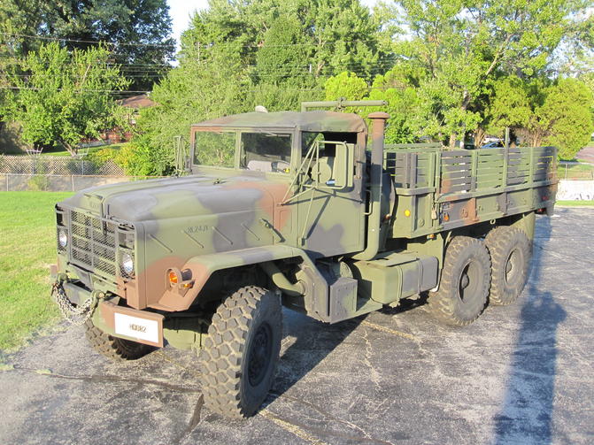

Heres some of the 14.00R20 trucks my business has put out over the last year.
My best advice is when you go with 14.00's. Go with either the Goodyear AT-2s or the Michelin XZL's. The Michelin XL tires are prone to heat buildup and catastrophic failure when ran at or below 50% tread. Ask me how I know!
