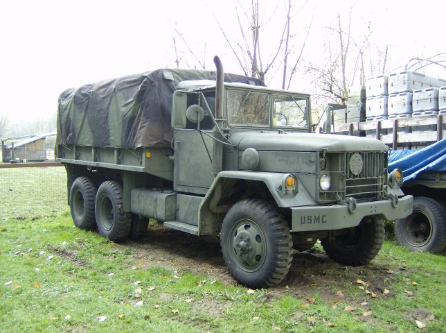

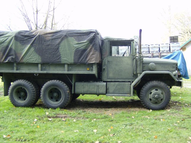

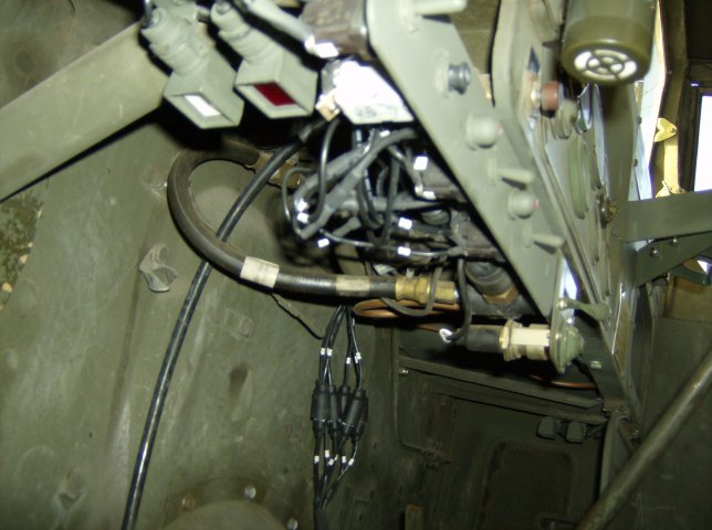

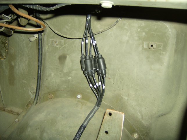

Here's my deuce, she's a 67 multifuel, doing lots of electrical upgrades to make it easier to connect just about anything.

Your right it is onbackwards isnt it, did that on one of my trucks once.
Nice solid looking multifuel. Any more upgrades planned or is the electrical all you had in mind?

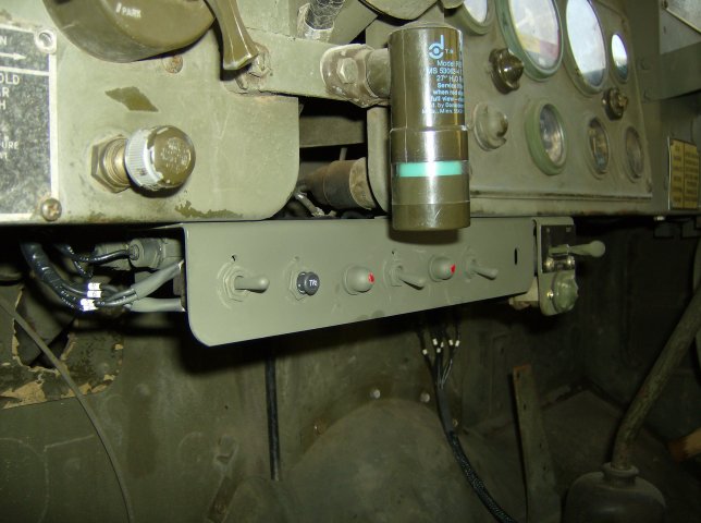

How about walking us through the switch panel under the dash? Electrical stuff is a weak point for me.

Looks nice. My two cents, if allowed, you should consider the screw-on black weather proof rubber covers for the toggle switches.

Good idea, I find them at Ace Hardware stores, not the cheapest place, but it's local.

Good idea, the switches I use are mil spec aviation grade so they are completely sealed already but the rubber would look good.
From left to right there is a on-off-on switch for the red/white floorboard and dome lights, next is a 71/2 amp circuit breaker for lighting/control power, next is an indicator for the on-off switch next to it that controls the 12VDC non-essential bus, next to that is the indicator and on-off switch for the 24VDC non-essential bus
Oh great, I put the top on backwards? The other end flap doesn't open up so I figured this was right.
Dave
I'm going to install a PTO and winch, and am building a custom aluminum camper unit that slides in the back.still need to get an intercom and a radio or two(got a PRC-77)
