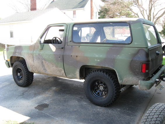

For illumination, I'm going to use small black LED license plate bolts.
I'm not a big fan of the under-the-bumper location, but it makes good use of the hole that already drilled there.
The tailgate plate is mounted on a 150 pound magnet that comes with screw eye bolt, and it's $20 from Northern Tool. I really like that spot for it, but there seem to be differing opinions on whether that's legal or not. I asked my brother, a state trooper, and he said no, it cannot be in the window. I haven't read anything in the inspection manual that says it cannot be there. If they say it can't be in the window because it impedes visibility, I would say that portion of the window is blocked because of the spare tire anyways.
At least I have a couple of options.

I'll try to remember to get a photo, I just used a simple aluminum angle and drilled three holes in the bottom of the bumper. I used self tapping bolts. I put an LED light in the angle above the tag. It takes about 2 minutes to unplug and remove the three bolts to play in the rocks, it is on the right side of the bumper and not as low as the spare tire.

This is what I did. The cops here are a pita and I was told I need to have the rear plate lighted when night driving. I also wanted to keep it as close as possiable to looking "as retired" non modified on the outside to show in parades. All I have to do Is slide a cover over it and remove the front plate. The box has the tool issue in it and was done before I got it from GL. Now the plate holder came from a Express van (newr chevy full size). I removed the handle part and rounded the corners to match the other side. The light is taped into the rear side marker on that side. The adapter plate is a scrap piece of plate I had laying around. it does vibrate a little, so next will be a support to mount on the edge of the plate to the box.
