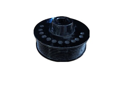

If that was the case then the pulley defiantly was not tightened up enough, it should be TIGHT against the shoulder on the alt side of the shaft, this pic shows the side that should go in against the shoulder.
If it needed to come out to align with the belts you had the wrong pulley on it, this one gives more offset towards the front of the vehicle.

I have one like this but it was too far out, this was the one I had that was to far out 8-Groove Belt Pulley ; Humvee M1114 ; RCSK18685 RCSK18219 3020014445447 | eBay

Its a Plumbing nut, I had miss place my previous nut but I found it last week and was going to change it.
I don't have the small pulley conversion kit but this pulley is the same size as my seized up clutch pulley

I got the pulley off, the shaft seems to not have any damage, could it be that the 200a generator is just too strong for the solid pulley and put too much stress on it when shutting the truck off over time? The clutch pulley never did this for the 2 years I had it on.
For the nut, the original generator with the truck had come with this strange looking nut in the picture, and the second new generator I had came with a nut that had grooves in it (I lost it)
