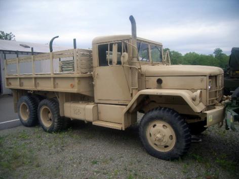

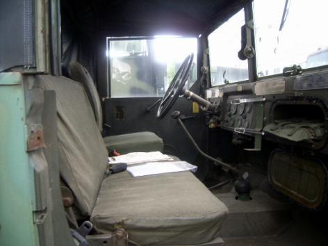

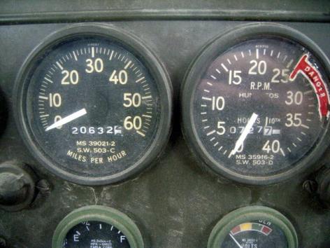

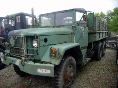

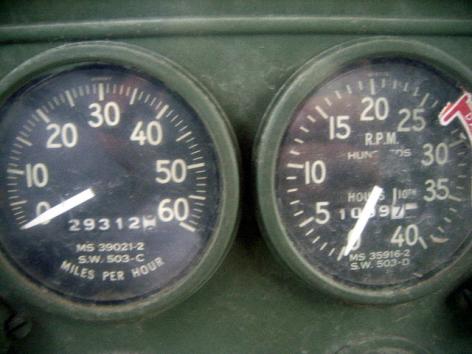

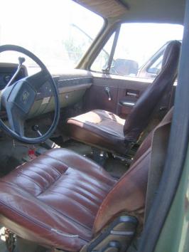

I won two M-35's out of Wright Patterson and a CUCV out of Oklahoma. Ive never owned a deuce before and I'm really looking forward to getting to wrench on one finally. List member "Heavy" or Eric with Hotshot Transport is brokering the transportation from Dayton to the house in west tennessee and he gave me a reasonable rate.

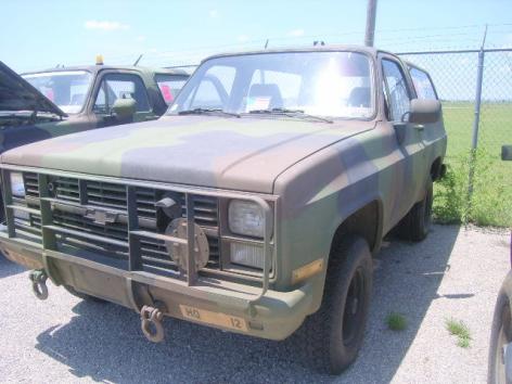

The CUCV is going to end up being me and a buddy with tools some fluids and good intentions kind of recovery. Its going to be great I havent been out to Oklahoma in years.
I bought a CUCV key off ebay, and I will probably get a spare driveshaft as the forklift monster likes to eat them from what ive heard others say here. If anyone has any advice on picking up from Ft Sill im all ears.

They all look good, especially the Oh-9. I didn't see any forklift tattoos on the drivers side, you may get lucky. If not they are a dream to flat tow. Take a vehicle capable of towing it if you can and take a towbar along too. This is good insurance. Maintain a tire budget too, the old ones with the nice tread tend to explode on the highway. I see an adventure in the making.

PS: You will need a CUCV key if you don't have one. There are guys that can help you with that too if needed.

Dave, the light towbar would work as would the medium one. The CUCVs use the larger adapters. A tow dolly would also work. If you tow it make sure the transfer case is in neutral and consider disconnecting the drive shaft at the rear differential and wiring it up out of the way.
Take a couple of charged batteries for the M1009. A CUCV will not start unless there is at least a little charge on the batteries. If one of them, particularly the front one is dead and won't take a charge, it won't start.
If it were me I'd take a complete set of belts and a fuel filter. Give it a real stiff dose of Lucas fuel treatment for the first tank or two. It has a 27 gallon tank and with good injectors and a clean air filter it should get something like 20-22 MPG on the highway.
This time of year I'd also take a can of wasp and hornet spray.
Good luck and enjoy the experience.
