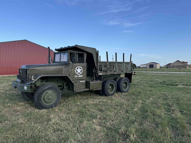

Hi all, I just picked up an unseen M51A2 from an auction site. It was a bit of an impulse purchase that resulted in about 50 hours of research, during which I'm much more educated about what I bought. I purchased the truck to move about 250 yards of dirt around my property. It should be a fun journey.

I just got home and took a look at the M51. Well... the "All wheel drive. Starts, runs, drives and dumps well. This truck is ready to go" is a drastic over-exaggeration of reality. 50/50 If I'll part it out or get it going.
That sounds pretty sad. I mean the paint job looks really nice. What about the internals? Are the Gear boxes, Motor, and Brakes okay? Or are at least some of the parts good?
Send it back and get your money back. They're all GSA Arkansas turn-in trucks..

Dump trucks are always worth more assembled than in parts. Wow the picture you first posted sure did look good except for the ridiculous stenciling. They call that “lacquer overhaul” in the construction equipment biz.

100% a lacquer overhaul with bad stenciling.
After much thought, I have a path forward. While it will be more expensive than I initially estimated, I am confident that the result will be something useful that I'm proud to own. When done, it's going to be a 25k—45k truck. I'm not sure I'd ever get that out of it, but I'm sure I could get .50 cents on the dollar.
