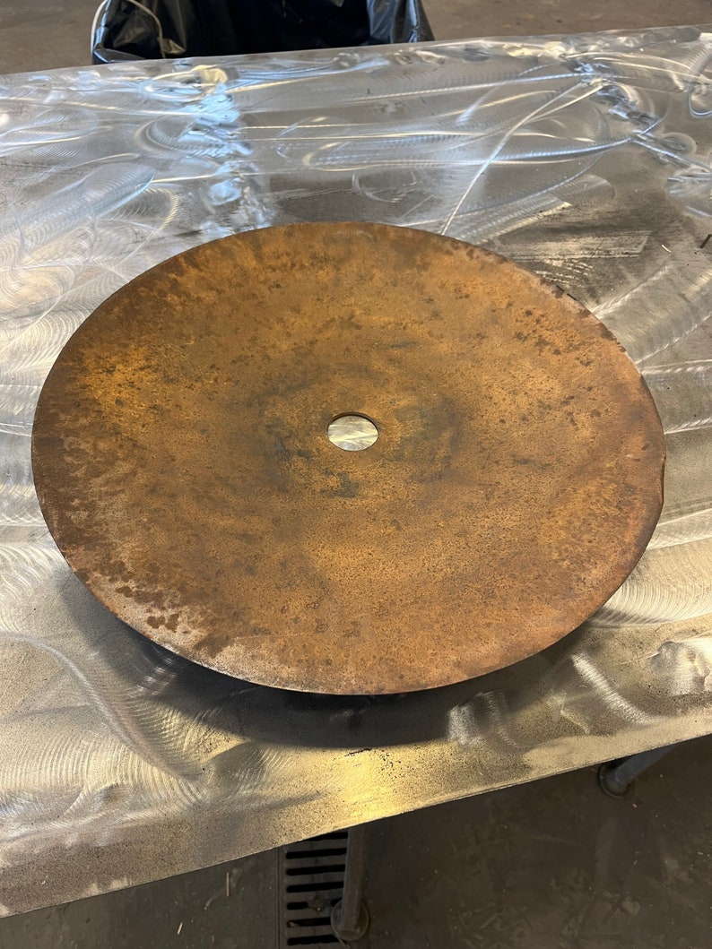

Ive been thinking about this anchor and how and where would i put this some where on the truck that wouldnt be in the way the 99,9 percent of the time i didnt need it ! I think ive come up with something that might stow easier and have more anchor material for our heavier trucks to pull against with just a little light fab work ! https://www.google.com/aclk?sa=l&ai...wjZuoKMpfmCAxURkokEHR7PC5AQvhd6BQgBEI4B&nis=8 Use a few of these farming disc/plow wheels which you could might find for free from local farmers scrap pile but run your pull cable thru the hole and stick a piece of pipe or cold roll thru the cable eyelet on the backside of the disc ! You would just have to dig a slot deep enough to sink the disc and maybe a small cable path in front and maybe a few more j

The large ground grabber / Spade is huge and bulky. I like the idea of a plow disc or a few of them. I could store multiples of them stacked together not taking much more room than one. Although linking them all together is another problem.
Short chockers meeting in 1 spot for pull cable to hook to all of them ! I figure 2 seperate disk pos. would be a lot of anchor pull but add more if needed

Im going to go with what ever the width of the side panel holder door is so i can slide that sise disc lieing flat with a couple chocker cables and some 16 in pieces of cold roll stock so maybe 18 to 20 inch disc and dont forget your round point shovel (very handy for many other things to have on your trucks)

I would think you would want a rigid connection to the disc. If it slides unevenly, turns on edge, and lets loose, you will have a frisbee instead of an anchor.

You might want to do some testing with the disc blades before you “need” them, as they tend to be kind of brittle, however bigger typically tend to be tougher. If they hold up they may be a very good option for multiples in the sand….

Yea should test it out and thats one reason i thought a long as possible pipe/bar would displace weight across the disc

Those disc are heavier than you think i dont see them going very far if it did pull out of the ground its all dead weight so just dont stand in front of or in the path of any winching ordeal for saftey sake !

The problem with a disc, is connecting to the center WITHOUT a rigid lever arm, means that it will need to be buried completely with a channel down to the disc center.
Even then that is no guarantee. since it can pivot where you attach to it, it may push up the soil above the pivot(path of least resistance) and as soon as it tilts past vertical it will slide up out of the hole.
There is a fairly easy way to attach a lever(t rod thru center with a chain from top of T to top edge of disc to hold it at a dig-in angle).
I dont see a disc wanting to dig in by itself in anything but sand though. Thats where the ground grabber or danforth anchor design has an edge. Basically self digging, and only go as deep as they need to. The ground grabber can be made flat, a danforth anchor is already flat. You can also easilly daisy chain them...
