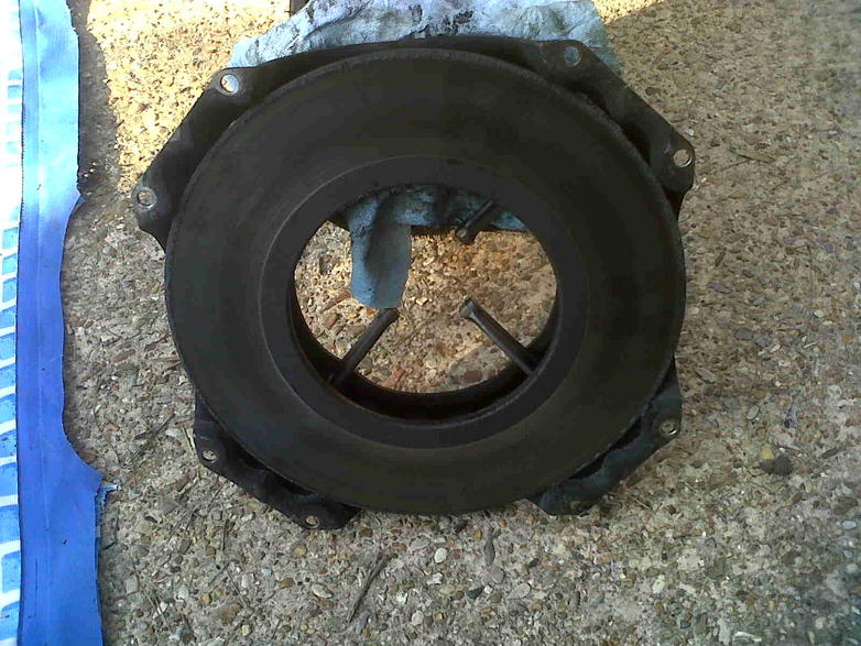

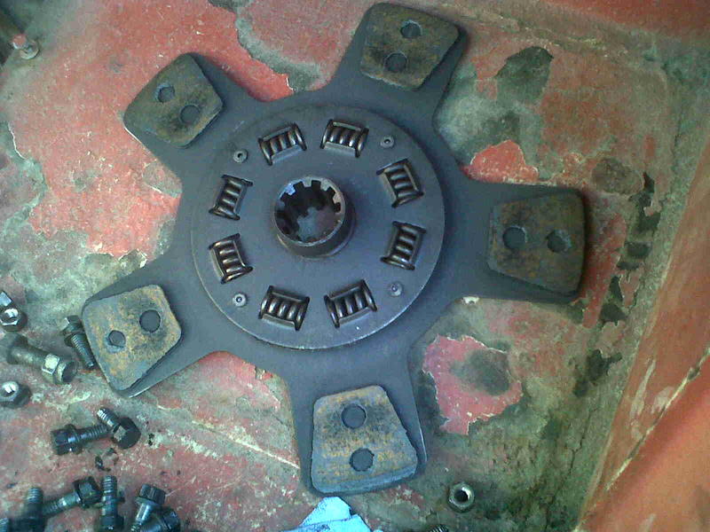

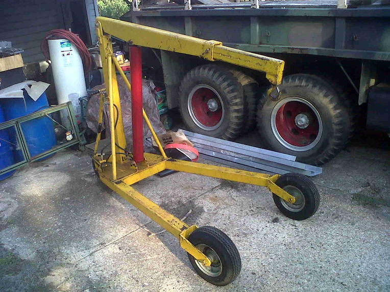

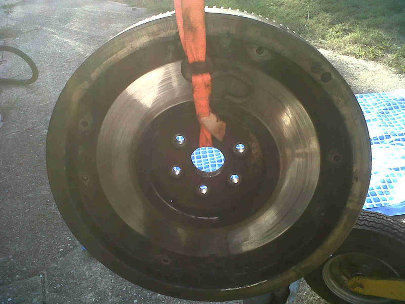

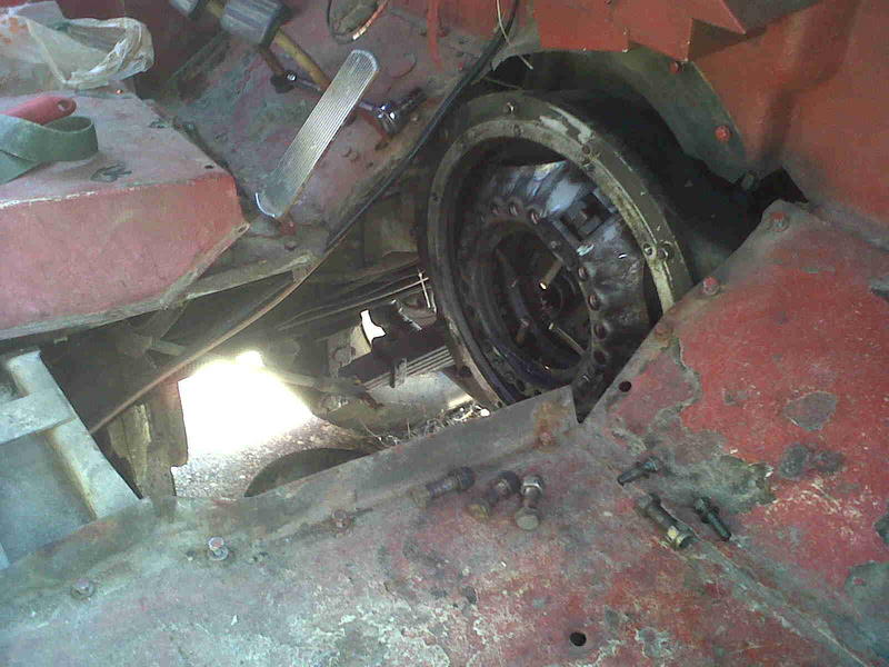

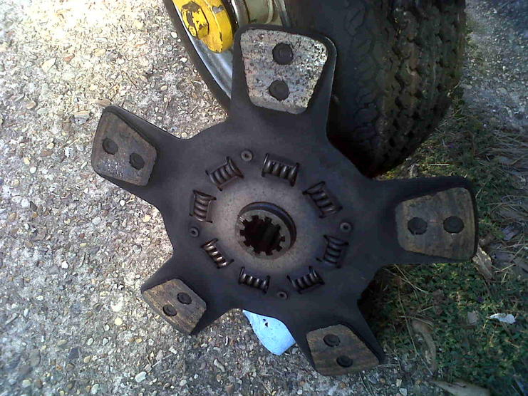

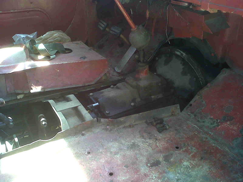

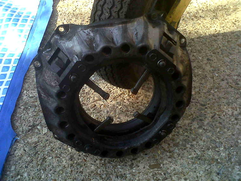

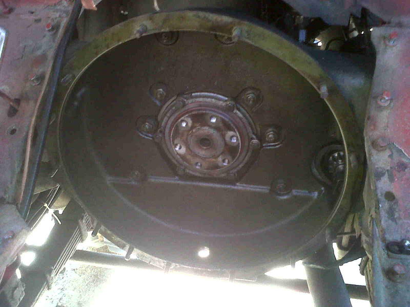

Finally got around to pulling the transmission and flywheel today. I had already done all the preliminary work like pulling the seats and tunnel covers. All I did today was to take loose the front drive shaft and actually take the transmission and flywheel out.
Taking the transmission out wasn't that hard, I just had to hold my mouth right to get it down between the engine and the crossmember behind it. Taking the adapter ring off also proved to be more than I anticipated as it hit the floor before it cleared one of the studs by the foot feed. The flywheel removal was also more than I planned. I knew the flywheel was going to be heavy, but I didn't know it was going to be THAT heavy. No problem though, just tie it on to the cherry picker too. And as always: Pics or it didn't happen!

I did forget to mention earlier that my truck has an English transmission. I thought that was neat. I also forgot to mention that my adapter ring had a broken off tap sticking out of the "front" of it that had gouged a little ring out on my flywheel. Also I noticed that all of the threaded holes in the ring had been heli-coiled. Is this common? I would tend to think so since the ring is aluminum. I was just curious about other trucks.

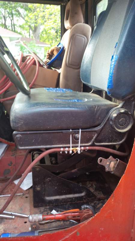

That's what this is all about, TJ. Get it put together ASAP so I can have time to test run it before the convoy. I did get to work on the seat today, but I didn't empty out the truck so I only took one picture. Hopefully I'll have another mod done before the convoy, but I'll let that one be a surprise.
